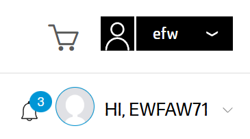

To get you the best assistance, we need to take this conversation to a private chat. We're inviting you to a private message to protect your privacy and ensure that any sensitive information remains confidential.
To access your private message, just click the little blue envelope icon on the upper right corner of your HP Community profile, next to your profile name.

There is no letter icon in the right upper corner,
