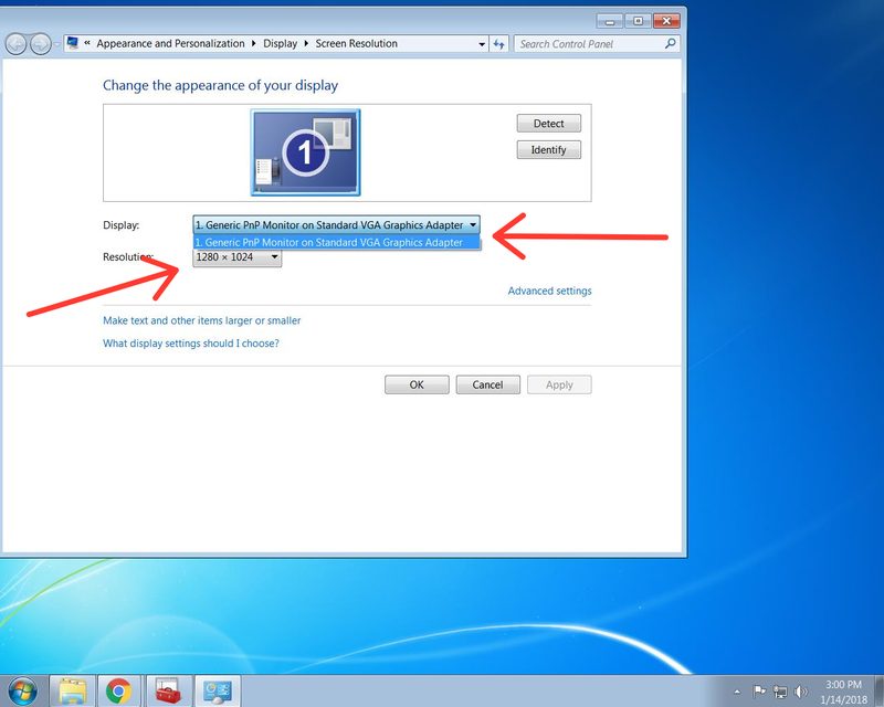

 Hi friend. Once again I can't thank you enough!
After following your advice things are running quite smoothly at the moment. Except for what still appears to be a driver issue with my display adapter.
Updated the display driver with the recommended HP driver but a reboot will only cause Windows to hang.
Some years ago I updated the BIOS which might have been a bad move on my part and I'm wondering if that has caused an issue. I say that because for a few years now I've sometimes had this warning: " display driver stopped responding and has recovered " appear. I had issues installing DisplayLink in the past but still worked as I managed to get 2 other monitors to work with my laptop.
The ISO image on my USB pendrive is Windows Pro and I installed service pack 1 and service pack 2 that you so kindly recommened. An antivirus is running and the Windows OEM license worked flawlessly. Thank you.
At the moment the display adapter(s) issue remains.  I use to be able to set the screen resolution to 1920x1080 but now I only have 1280x1024 option.
And I can't get my other 2 monitors to display anything because DisplayLink says I don't have the right configuration or resources (don't remember the exact wording). I just know it doesn't want to install, although I use to be able to install it.
And any attempt to install catalyst control center won't let Windows boot.
But I'm not deterred and will keep plugging away at it.
I hope you're having a great weekend and thank you very much for your continued help.
Cheers!
