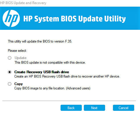

10-21-2022 11:48 PM
@Jrbreunig @NonSequitur777
Thanks everyone for supporting me,
I've tried to downgrade BIOS to its previous version. (I've download correct BIOS of my system)
I tried all available previous version of BIOS of my system,
but every time I try to install BIOS It says
"This BIOS update is not compatible with this device."
I've tried second option by creating recovery usb flash drive and try to install BIOS but it didn't work
Don't know 3rd option, maybe it can work.
