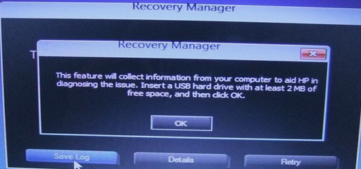

HP ENVY TouchSmart 17-j017cl Notebook PC  I have bought 4 recovery DVD FOR HP support one month ago, whenever iI want to recover it I recieve this error explained below.
As I was trying to fix it, I did the followings;
1. turn on wifi
2. bios date was set to before 22/06/2014
3. reset the bios to default
BUT THE ERROR STILL EXISTS!!!
Selecting save log prompts for you to insert a USB drive which basically shows the same message as Details (see below).
Message;
[15:35:01.68] ChkErrBB.CMD :  Detect some error during PININST_BBV.
[15:35:01.68] ChkErrBB.CMD :  Check c:\system.sav\logs\BurnBootWarn.log
[15:35:01.68] ChkErrBB.CMD :  or, check c:\system.sav\logs\BurnBootMerge.log
Selecting retry prompts for recovery media, basically the first DVD of the recovery media sent by HP.
There are four (4) disks total, 1 through 3 are recovery DVD’s and a Supplemental disk
