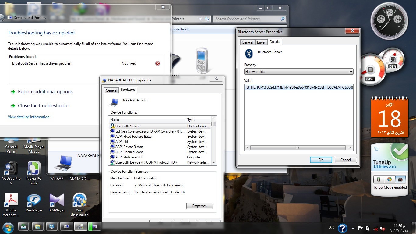

Dear Sir:
 This problem faced me in HP Laptop  for Bluetooth server in my HP laptop pavilion g6 2160 which its name Bluetooth server  and its type  Bluetooth Auxiliary and its   Hardware Ids  BTHENUM\{f0b2dd71-fb14-4e30-a62d-931874bf282f}_LOCALMFG&0000
This is pictures for the problem and I'll try to send these pictures to your email so as to show it.
Is This Your Coopporate  <HP.Support.Forum@hp.com>???please answer this question ,And if not send your company email so as to send pictures for you and I promise you I'll keep in touch with this site.
please try to solve this problem soon
Many Thanks Sir
