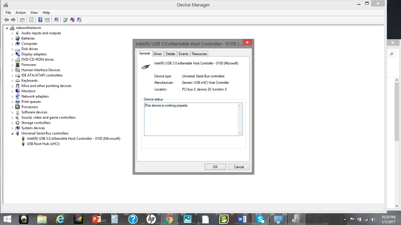

Hi! Yesterday my mouse quit working. It blinked a bunch of times and stopped. I bought a new mouse. It won't work either.
I took the old mouse to another computer and it works fine on that one. I tried the mouse back on my main computer with other USB ports and none work with the mouse. The USB ports work fine with my phone, camera, fans etc.
I changed the USBsettings to not turn off when low power. I reset the computer to a week ago. I unplugged the computer, took out the battery and then restarted it. I did that again without putting the battery in it. I checked for updates on the USBs-computer says they all work fine and no updates. I updated windows 8. I did a system check for errors-nothing.
Spent most of my day on this. What's up?

01-01-2017 08:49 PM
Kazi, Thank you for the information. After running the component diagnosis tests, it shows all the usb ports are not working. I tested them with my flash drive and verify they aren't working. My laptop fans works on them all though. So this brings the problem then to a higher level. Is this an easy fix? This computer isn't all that old, about three years. Model #15-do35dx
Please advise:)
01-02-2017 12:23 PM
You are welcome and thank you for trying the steps provided. 🙂
I must say that technical troubleshooting steps can only be provided, but it was you who implemented them to perfection. Kudos to you for that.
I suggest you to reach out to HP phone support because the USB ports have a hardware issue. HP phone support will check and let you know the hardware service options available.
Please keep me posted if you have any more questions. Take care! 🙂
