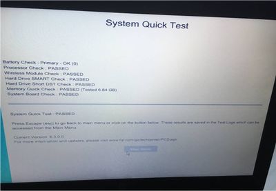

I've refigured it so it doesn't automatically restart, but I don't know how to create a kernel file. I couldn't find anything about how to with the link you gave me. I did the system check from starting the laptop up and the picture shows the results, everything is ok with that.

It's good that the hardware tests passed - this makes me believe the issue is software related - probably with some misbehaving driver on your PC. Drivers needs to be updated. You can skip "HP PC Hardware Diagnostics UEFI".

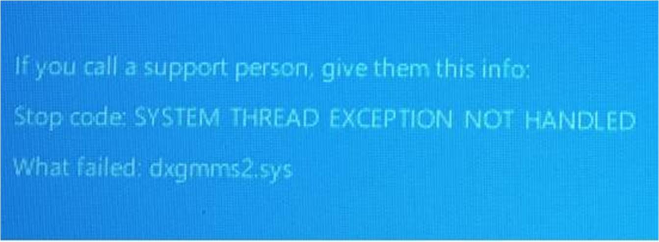

this is the full message that appears and it came just a moment ago, had to restart manually laptop.

The picture does not show very clear but I think I see some name at the very bottom - like  .sys
Can you please post back the  .sys name
or whatever you see in the bottom of your message (white text)
Thank you

Is this better?
Hi,
Yes, much better. We can now see clearly where is the fault. The problem is from dxgmms2.sys
You can Google this "term" > dxgmms2.sys and you can see it is common one.
This driver is a Windows driver for Direct X.
This proves it is a software problem. Possible reasons:
- your video card driver is corrupted or faulty (e.g. recently updated) - Nvidia or AMD to blame
- your video card drivers is not compatible with some update of Windows 10 (e.g. recently release Win 10 Creators Update or other)
- Windows is buggy - some recently pushed MS Windows update caused this - Microsoft to blame...
As mentioned before BSOD is kind of Windows self-protection feature. If you received a blue screen error, or stop code, the computer has shut down abruptly to protect itself from data loss. This is a driver fault in the memory of the PC.
