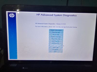

 I tried to install them and a partition is created (with the possibility to create it in a usb stick) called HP_TOOLS where files are inserted. The only difference I noticed is that at startup of the pc, pressing F2, you enter the hardware diagnostic utility, which without the installation of these drivers was shown as a simple black screen with white writing, while after the installation of these drivers is shown a GUI, with an additional command to update the BIOS, but since without an updated BIOS file is useless.
Is it possible that it's just a graphic update??

I think you're talking about this, it's possible
HP PCs - Testing for Hardware Failures | HP® Customer Support

Yes, section "Testing hardware with HP PC Hardware Diagnostics from an external USB device" when i have installed the driver on an external usb and boot with pressing F2, although graphically it is different, and "Using Basic HP PC Hardware Diagnostics" are the same style of the screen without that driver... Not equal, but the style is that
Plus i have an option to update the BIOS.
so, I think we have the answer to the question here
This does not change the bios to UEFI, but this
