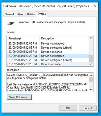

I wanted to upgrade my HP 2560p WIN 10 machine to a SSD. I bought a Samsung SSD (860 EVO) 1TB last week. When i tried to connect the SSD to my laptop via a USB3.0 SATA cable, i kept getting this error that the "USB device is not recognised". I searched a lot of forums but could not find a solution. I finally came across this HP support forum, so i thought i would post my issue here, in the hope that someone might be able to help out. Thank you in advance for looking into my request.

Error I receive when i connect the SSD into the eSATA port or any other USB port.
Unknown USB Device (Device Descriptor Request Failed)
Device USB\VID_0000&PID_0002\6&8d80eca&0&3 had a problem starting.
Driver Name: usb.inf
Class Guid: {36fc9e60-c465-11cf-8056-444553540000}
Service:
Lower Filters:
Upper Filters:
Problem: 0x2B
Problem Status: 0x0

Hi Paul,
Coming back to the first error that I pointed out was for the SSD, that I tried to connect to the HP 2560p via a cable (USB3.0 to 22 pins SATA). Since the SSD is a brand new one, I was advised to first connect it to the laptop via a cable. Once the laptop detects it, you use the disk manager to format it and assign it a drive. Once you assign it a drive, you can then use Samsung Disk Migration tool to clone your existing HDD into the new SDD. Which is my end objective.
So every time I connect the SSD to the Laptop USB Port, I get that error.
Service:
Lower Filters:
Upper Filters:
Problem: 0x2B
Problem Status: 0x0
Any help or suggestions will be appreciated. Thank you for looking into this.

Update: I finally managed to buy a USB 2.0 to 22 pin SATA cable from eBay and the laptop instantly detected the external SSD. So I  managed to clone my HDD into my SSD and solved the problem.
