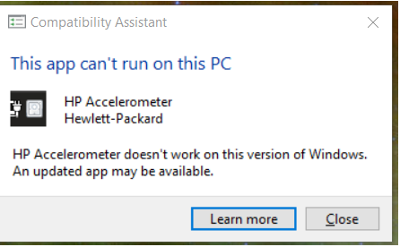

For the past few months I have seen a window pop up during boot that "This app can't run on this PC" This failure concerns "HP Accelerometer"
The device is up to date with all ms software updates ,,,now v1709 (OS Build 16229.19. HP software is a different matter. As with most of our HP machines, Support Assistant refuses to install most of what is displayed in the program after running the app! At the time this pop up was recorded there were no updates available in Support Assistant.

Hi Chinney_83
Thank you for your help. Installed the software from your link...reboot and no error pop up. Now have HP 3D DriveGuard icon again in start tray. I wonder why HP Support Assistant would not give me the update, but then it has always been troublesome for me!

I take the same error. I downloaded and installed the recommended file , but still take the same error message and "Accelometer" not works. Thanks.
Good Morning again!
Just updated to win 10 Pro v 1709 (OS Build 16299.64)...Got the same error again after reboot to finalize the update from ms....same as posted at the thread starter. (‎10-22-2017 02:55 AM). So the fix was short lived!
