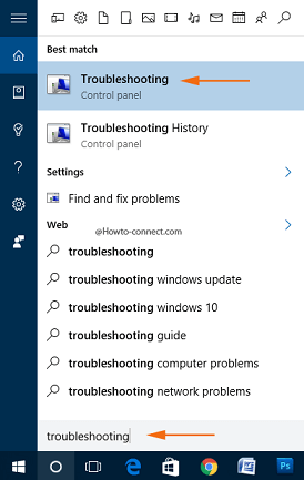

Click on the Start button to open the Start menu.
Type Troubleshooting.
Open the Troubleshooting app.
Click on view all option on the upper left corner.
Select the Hardware and Device options from the list.
Click Next to run the Hardware and Device Troubleshooter.
Follow the on-screen instructions
