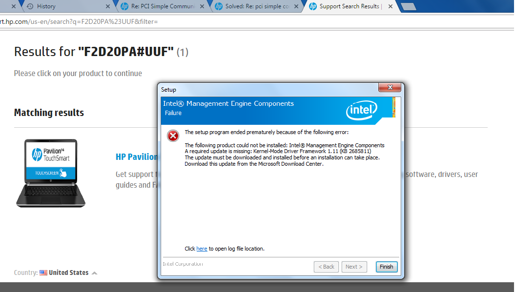

I've already downloaded Intel Management Engine Interface (MEI) Driver but everytime i  try to install, i keep getting this error message "the following product could not be installed: intel management engine components a required update is missing:kernel-mode driver framework 1.11".

HI, thanks for the quick reply, i've tried to download and install sp66636.exe and sp76159.exe but same thing. BTW, here's the Product Id: F2D20PA#UUF.
And i always get this thing wherein i couldnt bypass the installation of Intel Management Engine Components Driver everytime i try to install it:(see image below)
And i also check the other that Paul provided and tried to manually install it but get this error(see image below), i guess because i couldnt complete the installation.

The error report in your screen shot indicates 'Another Installation is already in progress,' so try this.
Click on the IMEI device, and select uninstall.  Check the uninstall driver box, restart the PC and try installing the newer driver again.
Hey Paul, here's what i got when i tried to re-install it (see image below)
If i could only install this missing: Kernel-Mode Driver Framework 1.11(2685811) in my windows 7 64-bit and this might fixed it.
Do you have guys any idea how to install this update? Thanks in advance!
