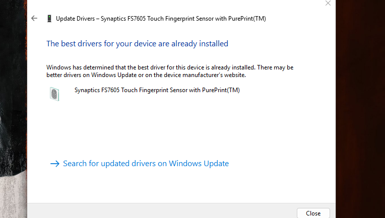

Okay. So few days ago, I automatic repair my laptop. After that, my fingerprint scanner was not working So I go to the device manager There is a un updated driver. Which gate a last date on 2022 When I'm trying to automatic update. it is showing me it is. already up to date Uh, when I'm going into. Windows update isn't. any new update coming. i am getting code 43 This is the Driver, which needs to update.This is the Driver, which needs to update.Screenshot 2025-05-04 125838.pngThis is the property of this driver. And there is a date. of last update.This is the property of this driver. And there is a date. of last update.And I'm trying to auto update it. It is showing me this. when I'm going intoAnd I'm trying to auto update it. It is showing me this. when I'm going into

Think i found a solution. Enter bios (esc, bios setup), find and choose "Reset fingerprint on boot". When you boot up everything would be alright. Maybe at first you must delete Sinaptics from "Device manager" (in Windows)

I did your soluce and it's right with "Reset fingerprint on boot" in BIOS
