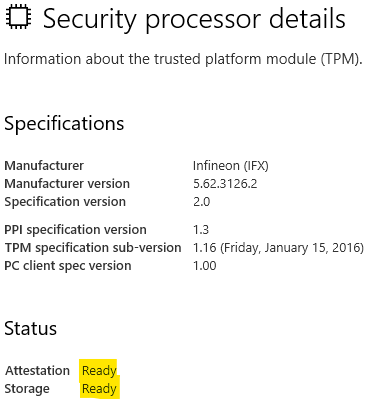

Since I have BitLocker enabled (encrpyted drive) I SUSPENDED BitLocker before installing the TPM update. Laptop rebooted once, Windows Hello with face recognition worked directly and BitLocker was automatically enabled again after a while. All TPM security messages were gone without wiping any data. TPM manufacturer version is now 5.62.3126.2.

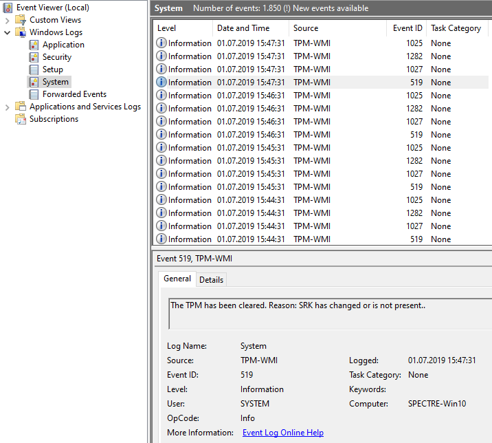

Incredible... today I updated to Windows 10 Version 1903. The update went smooth, no issues. After about 2hrs working after the update, I am all of a sudden greeted by a Windows Blue Screen due to some ndis.sys exception. After the reboot I checked the Windows event log and did not find anything pertaining to the BSOD but there were lots of TPM Information events.
These events seemed to run every minute and always resulted in an event stating that the TPM cannot be provisioned for use automatically...

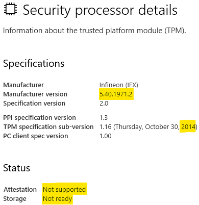

I thus looked up the TPM status in the "Security Processer" settings and what do I see?
The version seemed extremely old and I started googling and came accross an HP Security Bulletin linking to TPM Updates... only then did I remember that I previously updated the TPM and that I documented it in some HP support forum... So here we go again. Somehow the Windows Version Upgrade downgraded my TPM version!!! This time there were no nagging info's and would it not have been for the BSOD, which was probably unrelated, I might have never known! Maybe it has been downgraded for some while already without me realizing, but I only see TPM event logs after the Windows upgrade.

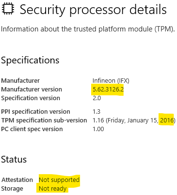

So I followed my own above documented procedure again and downloaded the same update file from HP. This time I did not have BitLocker enabled, my SDD is currently un-encrypted. I installed the update, rebooted, and could even log-in with Windows Hello or my PIN without problem. But:
TPM Version has been updated but it is still not ready, supported, whatever. Windows event log entries continued to pile up. I thus booted into the BIOS (F10 during boot) and in the "Security" section there are some TPM entries. "TPM Device" was set to "Available" but "TPM State" was set to "Disable"! I sure did not disable the TPM and don't know the status before the Windows Upgrade but this obviously made no sense. I enabled the TPM State setting and rebooted, it took a couple of minutes but now all seems to be back to normal:
Windows Event log only showed one more round of TPM event entries with the last one stating "The TPM was successfully provisioned and is now ready for use."
