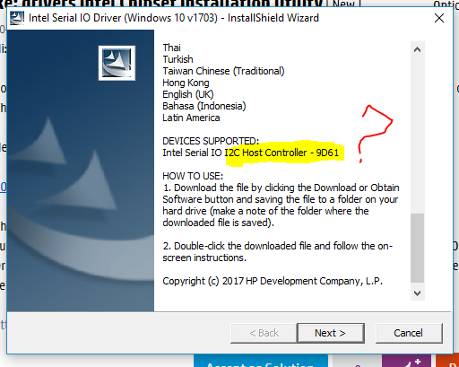

thanks for the help, but it's OK that there is written "DEVICES SUPPORTED:
Intel Serial IO I2C Host Controller - 9D61 "??? and I have 9CE1"???:smileysurprised:
I just checked the setup information files for the driver I posted, and it will not work for the hardware ID your notebook has.
I'll check later to see if I can find a newer one than what is listed on the support page for your model.
not installed.. this platform is not supported:smileysad:
