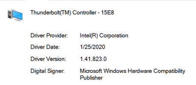

Good morning, I am trying to connect my Elitebook840 G6 to an Apple Thunderbolt Display. I am running Windows 10, version 20H2 (64-bit). I have searched for solved answers to this problem, but cannot find any current information for my specific device. I'm hoping someone can help, I have been trying different solutions/drivers that I have found on this board  for a few weeks to no avail.
- I have confirmed that my device supports Thunderbolt (not just USB-C)
- I am using a Thunderbolt 2 to Thunderbolt 3 adapter (I have tried with both the Apple adapter, and a this Startech adapter)
- To my knowledge, I have updated all drivers to the latest versions, per HP support website (with the *exception below)
Here is what I see:
Device Manager:
Devices & Printers:
Thunderbolt Control Center:
Possibly relevant information:
1. *When I update the Thunderbolt (TM) Controller 15E8 to the Intel Thunderbolt driver listed on the HP website (SP13448), there is an error (Windows has stopped this device because it has reported problems (43))
2. I use a VPN for work and have tried when logged in and logged off.
3. The Startech adapter that I am currently trying says before it will work, I have to update the Thunderbolt software, Thunderbolt controller NVM firmware, and the Thunderbolt controller drivers. At this point I am confused whether or not I have done this - I only see "Intel Thunderbolt Driver" -as mentioned above- on the HP driver list for my device.
If someone could please help me figure out what I need to do to make this work I would really appreciate it.  I'm afraid that I have tried so many different ways that I dug myself into a hole. Thank you!

Are you basing this comment on my specific device and question or making a generalized statement about PCs & Macs? I have to imagine that since this problem has been solved with other HP devices on this forum, that it would work with mine as well.
Regarding your second comment, thank you for your concern but I already owned the display.
Thunderbolt displays work on PCs, regardless if they're Apple or PC-compatible.  Look it up.
The problem is ubiquitous.  I have a Razer Core X that my HP Elitebook 840 G6 absolutely refuses to initialize.  It used to initialize my smartphone and prompt it for file transfer, etc.  It doesn't do that anymore.
So the question remains, after all that OP has done, what is left to do to make this work?
