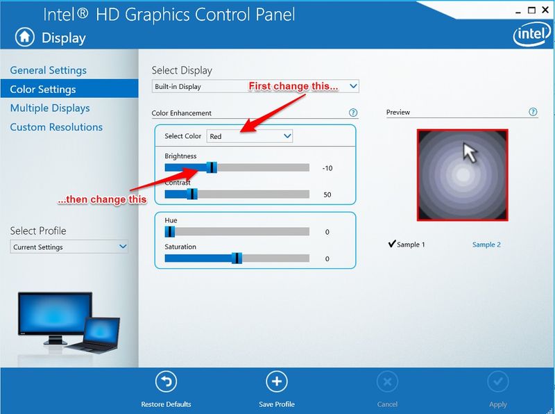

Problem: I found the display on my HP Spectre x360 (Spring 2017 version) was slightly yellow. That is, when I had a white background (e.g. in a web browser) the white had a slightly yellowish tint. I wanted to change this, and reduce the yellowishness.
Solution:
Right click on the desktop background > Intel Graphics Settings > Display > Color Settings
In the section labelled Color Enhancement you'll see boxes for Select Color (initially set as All Colors) and for Brightness.
Go to Select Color > Red. Then reduce the value for Brightness using the slider. I reduced it from 0 to -10.
Go to Select Color > Green. Reduce this value for Brightness, again using the slider. I reduced it the same amount: from 0 to -10.
(Red + Green = Yellow) You may try different values according to your preference.
Click Apply.

You might have more luck using the calibration utility in Windows itself rather than the Intel app.
https://www.windowscentral.com/how-calibrate-your-pcs-monitor-windows-10
Thanks. I forgot to say I tried that, but I couldn't get it to change the white balance / temperature. Maybe I missed something there, though.
Go through it slowly and pay attention to how the image looks, particularly the guy with the white shirt.
