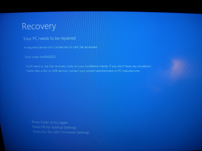

   I was thinking about this problem when I was going to work this morning then it kind dawn on me that if I were to remove the LCD Connection the computer would be force to use other video outputs (VGA or HDMI).  If that worked that it meant that the problem would be only on LCD, if they didn't that it probably a motherboard issue. So early today I remove the LCD from the computer and connect the TV via the VGA output and Lo and Ho behold was I able to see output my TV. I know there is an error, but is because the LCD need to replaced.  At least now people with the cracked screen issue can test to see if the problem is the motherboard or the LCD. Hopes this helps somebody that has issue.
(Sorry the mage looks fuzzy with lines, but is not screen issue rather it a camera photo issue when taken screen shots from certain angle.)
