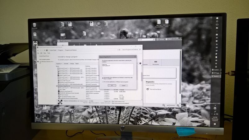

My company purchased an HP ENVY 750-514 late last year along with an HP monitor 25es.
I added a 2nd monitor through an ACER All-in-one and it was working fine.
Just this week, the employee who uses the ENVY reported to me that the display turned to black and white (or grayscale) since mid-december.
I took a look at it, uninstalled & reinstalled & updated drivers, switched out HDMI cables, tried different monitors, changed settings, erased unwanted software, checks for viruses and malware, checked BIOS (82F1 vF.11), ran diagnostics (F2), removed too much power charge (by disconnecting the power cable and pressing the power button for more than 5 seconds), etc., etc. I've ran out of options... unless I do a clean restore of drive C, but I don't really want to go there, yet.
Has there been a solution to this? I know we are not the only ones with this problem as I have seen other forum users report this very same issue.
I have included pictures so you could see what we are dealing with.
Thank you for your time.

I found the solution thanks to another forum user by the name of Just_Jay. Here's his original message:
"I suspect your cat hit Windows + Ctrl + C, thereby turning ON your Color Filter.
To correct: Settings > Personalization > Color > High contrast settings (under Related Settings) > set Apply color filter = OFF
Hope this helps, J."
THiS IS THE SOLUTION... well, to my problem of course.
Thanks MKazi for your assistance.
-KSOfficeManager
