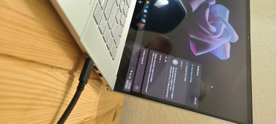

When I connect my envy 16 to the LG monitor (32QP880-B) via the thunderbolt 4 port, the monitor receives no signals. The USB-C port on the LG monitor support display, data transport, and 96 W PD delivery. There is a notification on the PC that "display connect might be limited". The PC is not charging either. It seems the LG monitor uses DP alt mode to transport data. The thunderbolt 4 on my PC does not support this mode? How can I solve this problem?

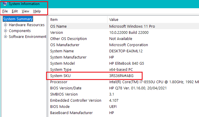

Yes, its  Thunderbolt™ 4 ports support Alt mode. You can use System info to find out what it is for example

I did ask what is your machine (its system SKU) ? Without knowing what is it, sorry I can't say.

the system sku is 6P6Z8UA#ABA. Please let me know if any information else is needed.
