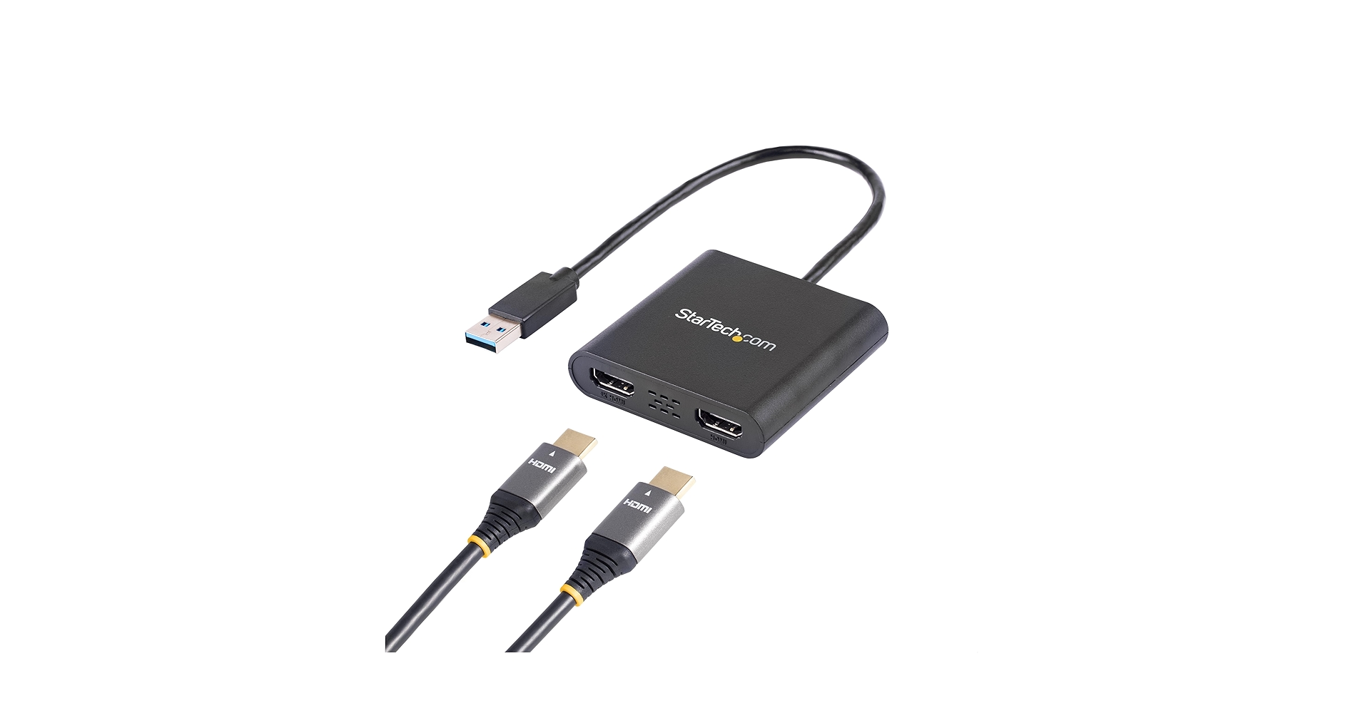

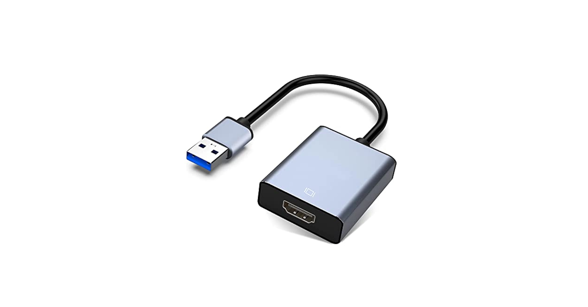

- Can I even see image from my USB-A ports since version aren't 3.0 (correct me if I'm wrong) so confirm if I can even see image at first, if not can I somehow upgrade version of ports with some additional adapter. If I can, should I buy some HDMI to USB-A adapter that goes to my USB-A (SuperSpeed USB Type-A 5Gbps signaling rate and 1 USB 2.0 Type-A (HP Sleep and Charge)) port and display second image with first connected to HDMI or just to buy dual HDMI to USB-A adapter and connect both HDMI to that adapter. Will that work as splitter that I already have or will display 3 different images (1 laptop and 2 extern monitors).

USB-A to HDMI Adapter
USB-A to Dual HDMI Adapter

If you wish to connect 2 external monitors (only-total 3), you can use
  • Monitor 1: HDMI direct cable,
  • Monitor 2: Using a Displaylink Certified USB-A to HDMI adapter such as
                                     USB to HDMI Adapter

@orolaa
Sure, fully tested on few different notebooks fro HP, Dell and Lenovo as long as it is DisplayLink Certified.
