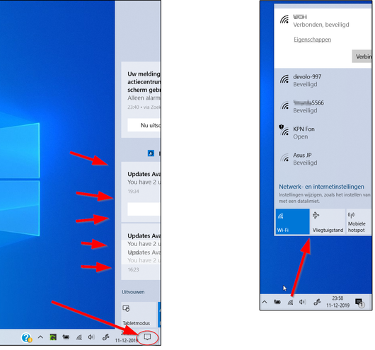

When using Edge or an edge based window like the settings screen, the windows will use the full available resolution.
This happens in full and in sizeable screen mode,
Edge is not using  the screen part in the right and bottom!Edge is not using the screen part in the right and bottom!
The same URL will render "normal" when I use Chrome instead of Edge.
Also when I click on the "Message Center icon" on the taskbar, it will popup partly out of screen, so you can not read it right.
Wrong scaled Message Center and Wifi  selection Wwndow.Wrong scaled Message Center and Wifi selection Wwndow.
Also when I click on the Wifi connection icon on the taskbar, the  Wifi partly also of screen and not connected to the taskbar as ussualy (floating).
The scaling problem can also be seen when using Calculator and with the settngs Window.
Settings Window Windows 10.Settings Window Windows 10.
I have reinstalled my Windows Home 10 x64 from scratch with Windows 10 1909. Installed the HP Support Asisstent (HSA) and the  drivers recommended within the HSA. Furthermore I have installed all Windows 10 updates to date.
Does any one know a fix for this problem ?

Hi Praveen, I did not use your solution (yet) because I wanted to know more about these Powershell command.
During my search I discovered that putting the scale at 100% "fixed" the scaling issue, although 125% was recommended.
Mouse right click on the desktop and choose Display Settings to the "Display" Settings.
Because my icons where to small I decided to play with the scaling by going to the "Advanced scaling settings" and adding several custom scaling sizes. (you have to logoff and logon for every change).
Changing the custom scaling some solved the problem and eventually I custom scaled to 125% without the issue reappearing.
Afterwards I removed the 125% custom scaling and set the standard display scaling back at the recommended 125% and the issues did not came back.
I have tried to repodruce the issue again after the above setiing changes, but I was not able to.
So for now I am happy this issue is gone and I hope it won't re-appear.
