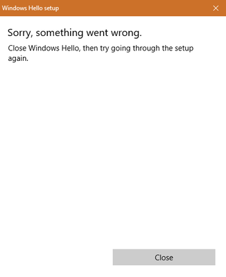

My fingerprint reader is not working as I get this error message: (Sorry something went wrong. Close Windows Hello, then try going through setup again.)
I have tried reinstalling the drivers, reinstalled windows, updated windows and even contacted Microsoft however I cannot get my fingerprint reader to work. It still displays in the device manager and says it is working but it doesn't actually work whenever I try to set-up my finger for Windows Hello. Another odd thing is that when I try to install fingerprint drivers from the HP website, it says that the drivers do not support the OS. This is odd because where do I get working drivers from?
Hello there, I actually fixed the problem yesterday (btw I did the HP assistant thing and updated everything fully but it did not work.
So the solution for anyone who needs it. I went into the BIOS and turned fingerprint Reset on Reboot to "yes" and it started working!

Thank you! Same issue!
Is it necessary to restore the option Reset on Reboot to "no"?
Nope not necessary.
