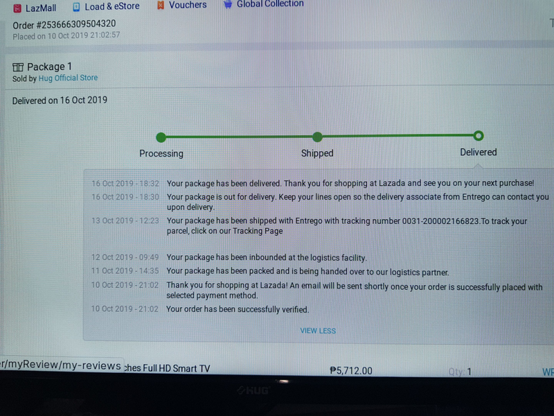

It looks the problem is in the display itself. What was bought as FHD (1080p) seems had arrived as HD (768p).
Which at the moment looks some type of fraud or mistake in packing the display in the wrong cartoon, because also in the cartoon it says FHD1080p.
There is 2 model of this display HUG32 LT32 (1080p) and HUG LT32-Smart (768p) and it looks they had sent me the HUG LT32-Smart (768p) inside the HUG LT32 (1080p) cartoon:
Screenshot_20191124-200408_Shopee.jpgScreenshot_20191124-200436_Shopee.jpg20191104_200042.jpg20191126_173110.jpg
