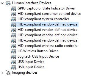

troubleshooting comes to a dead end when trying to  "Verify the touchscreen driver is enabled" under human interface devices, there no "HID-compliant touch screen"  listed. Device Manager.pdf

Request you to uninstall all the HID vendor defined devices from device manager.
Restart your computer and install all Windows updates and run HPSA again.

Thanks for the reply and trying all the suggested steps.
