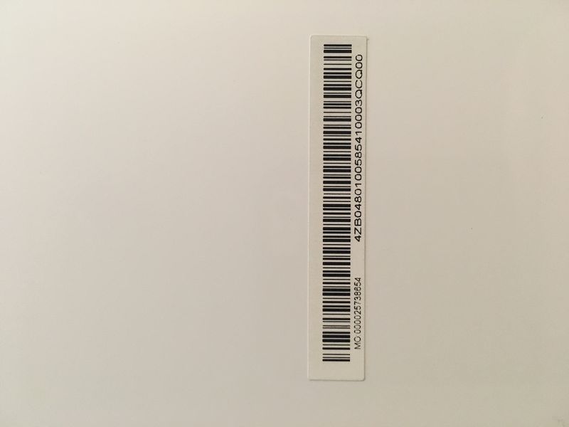

If it helps identification, I removed the screen and took pictures:
Thanks, Bob
@Raddodge,
I recommend you contact a local tech if you do not want to contact support. I don't have any information about the equipment used to check the display functionality.
Cheers!
