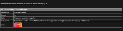

My camera appears to have stopped working and I initially noticed this when I stopped being able to log in using facial recognition.
I have run the diagnostics in the HP Support Assistant and it report the camera is okay until I ask to view the image and a white screen is shown. Does this indicate the camera has failed?
