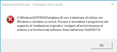

7- I followed the suggestion of the message in point 4 and downloaded the "win10-radeon-pro-software-enterprise-20.q4-nov10.exe" drivers from the site www.amd.com. Unfortunately, this installation also gave an error, as you can see from the attachment "7_Error during Radeon-pro-software-20.q4-nov10 driver installation";
8- at the end of the failed installation I also have another error ("8_Error after Radeon-pro-software-20.q4-nov10 driver installation");

I did this further test: if I directly install the AMD video drivers "win10-radeon-pro-software-enterprise-20.q4-nov10.exe" the screen backlight does not work in any way, which remains fixed at 100% and pressing the keys "F2" or "F3" does not change.
Right now the backlight works perfectly, but not the video drivers: several programs recognize only the integrated R5 video card and not the dedicated video card (R8 M445DX or R7 M440).
