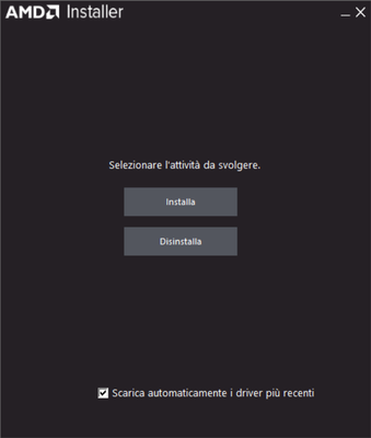

    I have installed the sp75640.exe driver (as attached "2_sp75640.exe driver install");

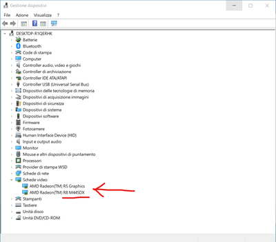

5- I checked in the device manager and I found that the recognized video card does not seem to be the correct one ("5_Device Manager with ambiguous graphic card model"); there appears to be a dedicated R8 M445DX video card;

7- I followed the suggestion of the message in point 4 and downloaded the "win10-radeon-pro-software-enterprise-20.q4-nov10.exe" drivers from the site www.amd.com. Unfortunately, this installation also gave an error, as you can see from the attachment "7_Error during Radeon-pro-software-20.q4-nov10 driver installation";
