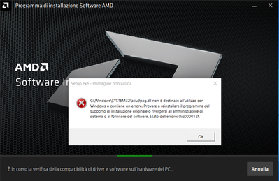

7- I followed the suggestion of the message in point 4 and downloaded the "win10-radeon-pro-software-enterprise-20.q4-nov10.exe" drivers from the site www.amd.com. Unfortunately, this installation also gave an error, as you can see from the attachment "7_Error during Radeon-pro-software-20.q4-nov10 driver installation";

I see that there is no graphics available from HP for the Windows version 20H2 for your computer. You need to install the driver using the Windows driver updates or downgrade the operating system.

If I install the drivers though windows update they don't recognise correctly the M7 440 video card, and also the backlight stops working and it goes to 100% brighness. I cant use my laptop with 100% fixed brigthness.
The driver on windows update is "Advanced Micro Device, inc. - Display  - 10/26/2017 12:00:00 AM 22.19.180.1025" I installed it but it doesn't work, the screen backlight does not work in any way, which remains fixed at 100% and pressing the keys "F2" or "F3" does not change.
As you surely know, it is not possible to downgrade windows to a specific version, also can you tell me which old version of windows to install?
I'm sorry but you haven't answered any of my questions, and I'm still having video card issues and can't use my laptop.
