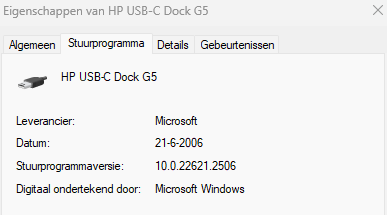

The driver that I have on my laptop is:
Do you experience the sames issues on your 'older' driver?
