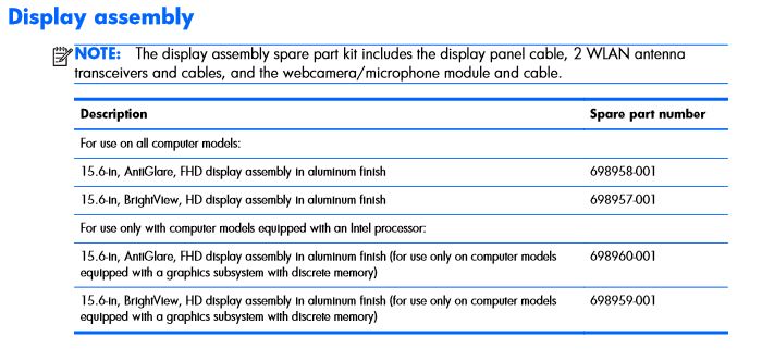

Hey,
I need to change my display because it broke, but instead of replacing it with the same exact display I was thinkin I could replace it with a better one. The thing is my courrent display has a 1366 x 768 resolution, but since my graphics card can handle more (and frankly I would love more) it seems to me it would be kind of a waste not to go with a Full HD display. I was wondering if anyone cuold tell me the serial number of a compatible display that has a 1920 x 1080 resolution.
There's another thing. It would be nice if the new display was also touch-screen, I mean, it's not necessary, but it would be a useful feature. The question is can it be done? If it can could you also wrigth the serial number of a compatible one?

I understand that you have an HP ENVY dv6-7320el Notebook and the would like to know if you could replace it with another screen that can support a 1920 x 1080 resolution. From one of your other posts, I see that that the battery does not charge and displays a message saying "plugged in and not charging". The light where the charger connects to the laptop is always on. Not to worry, I'll do my best to assist you with this case.
During my research, I came across the service guide for your laptop. Page# 95 gives the list of compatible screens for this laptop model. Also, it gives information how the screen can be replaced.

Thank you, @MKazi !
Regarding the display request that's exactly what I was looking for.
