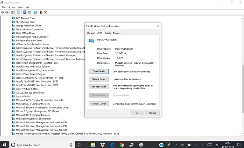

Hi,
As suggested I tried that, installing the older version driver from the website(See the snapshot for driver version)Virtual Button Driver.jpg. Update is nothing helped. Problem is still same as it was on day one.
Is there anything you may suggest.
Regards
Himanshu Mehta
