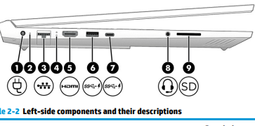

USB-C port "7" supports DisplayPort 1.4  video as discussed on page 4 of the users guide.
All you need is a quality USB-C to HDMI cable.  There is no need for a USB2/3 type adapter.
Can you provide a link to any cable or adapter you bought for the USB-C?
You also have the HDMI port so your laptops easily supports two external displays.
The other USB-C do NOT support video.
If there is no signal out of 7 there is a problem with the cable or the laptop.

The adapter is the correct one to use
It will only work in the port #7 i
