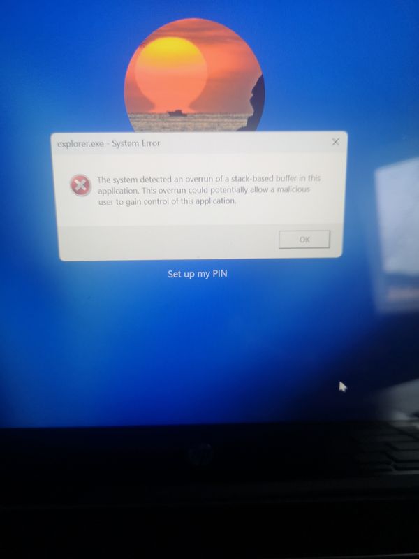

I opened Device Manager and the "Mice and other pointing devices" was not visible. This has happened before. I then plugged in the external mouse, refreshed and the "Mice and other pointing devices" option was visible and the external mouse was present, but no Touchpad device.
I then restarted the laptop and it generated a message regarding the PIN, advising me I had to change it, after selecting OK, it advised me to download an app, but when I clicked OK, nothing happened. After 30 seconds it generated an error message. I've attached screenshots of PIN message and error code, thanks.
