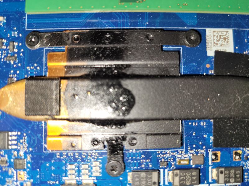

I couldn't help but notice the heat pipe over the GPU looked burned:

  • Heat Pipe Discoloration:
    • The burned appearance of the heat pipe over the GPU could indicate overheating. While heat pipes can discolor from manufacturing or use, excessive heat can damage surrounding components, including the GPU and display controller.
