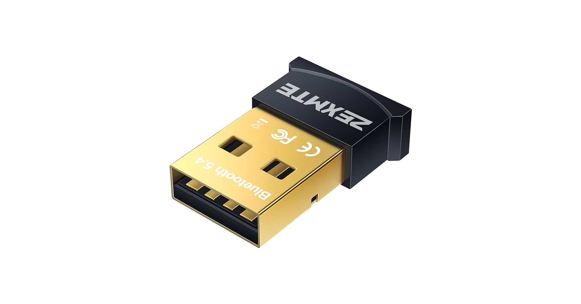

Yours does not have it so I am thinking you do not have a Bluetooth chip in the laptop. You can add one easily and cheaply with a device like this:
https://www.amazon.com/Bluetooth-Receiver-Transfer-Wireless-Keyboard/dp/B0775YF36R/ref=sr_1_3?s=elec...
