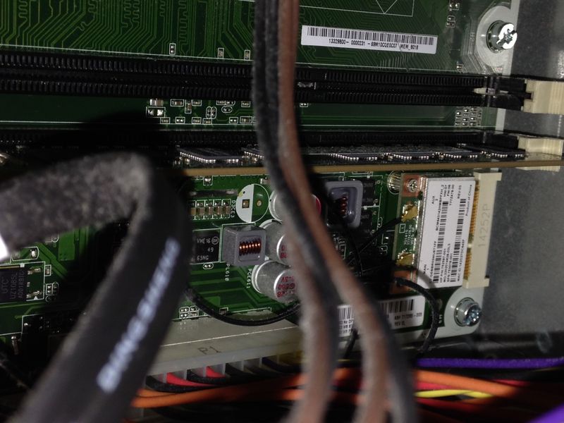

Hi
I think I found the adapter.  Lower left hand corner of the motherboard.  There are two wires that come out of the top of the adpater and run up through the wiring loom to the top of the computer case.  IMG_1671 (2).jpg
As I said in my last message, the adapter is working now.  I don't know if it is possible to shut the adapter off on a desk top.   If so, I may have done that.  At any rate, from an educational perspective and if ot fao;s again, have I identified the wi - fi  adapter?
Thank you for your help.  I will accept your comments as the soultion to my problem.
Thank you.
Al
You're very welcome.
Yes, that is it.
Your PC has a newer motherboard where the card actually plugs right into the motherboard, thus eliminating the need for the card being held in an adapter that would go into one of the black PCIe x1 slots.
I can clearly see the card with the two delicate wifi antennas connected to it with the brass connectors.
Thanks for showing me the picture.
You would unscrew and remove the wifi card and carefully pry off the antennas, and replace the card with a different wifi card, should the need arise.
Just be very careful when removing and reattaching the delicate antennas.
They pop on over the terminals.
