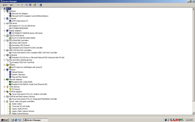

Hello. I recently tried installing Windows 2000 Professional on my HP Pavilion zv6000. When I installed all driver packages suggested by a third- party website, I still saw a missing PCI device displayed (photo 1).Photo 1Photo 1
 When I double-clicked the question mark, it showed like this (photo 2). Can somebody tell me what is missing here?
Photo 2Photo 2

Your screenshot shows the Broadcom wifi card as installed and working fine.

In order to find the driver you need for the PCI device, you have to look up the hardware ID for it, so you can figure out what driver it needs.
This is easy to do in Windows XP SP2 and newer operating systems, but on W2K, you need to do this in order to get the hardware ID for a device...
  1. Click: Start, click Run, type cmd.exe, and then press ENTER.
  2. Type: set DEVMGR_SHOW_DETAILS=1, and then press ENTER.
  3. Type: start devmgmt.msc, and then press ENTER. In the Device Manager, the properties for a device should now provide a Details tab that contains additional information about the device.
If you can't find the driver you need, please post the hardware ID for the PCI Device, and I will see what I can do to help.

Hello Paul, my computer is acting so weird right now. I have installed the Update Rollup and update the wifi driver, but it still displayed two local area connections only, but when I tried to enabling the Details tab, it does nothing. When I type set DEVMGR_SHOW_DETAILS=1, another C:\Document and Settings\User command appears, when I type start devmgmt.msc and double click on the missing device, the Driver Details is somewhat unclickable. So do you think is my Windows 2000 has problems or the commands is wrong? Hope to hear from you again.

It seems that I have no luck whatsoever, I tried reinstalling W2K Professional with SP4 as well as the drivers and the update rollup again. But it still does nothing, the only information that I could get from the missing PCI device is the location at PCI slot 3 (PCI bus 3, device 4, function 4). Do you have any idea what it is going to be? By the way, can you show me how to get to the wireless card utility cause I don't know where it is? Thanks a lot!
