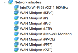

I unplug everything, power line, outside USB, and restarted the laptop , internet came back.
The following is what I have now.
Previously, I did not have the 1st item, Intel(R)  Wi-FI.
The wi-fi always has problems before when I plugs in power line, USB.

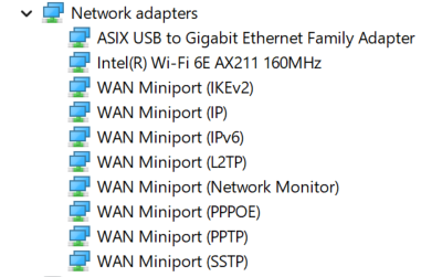

Just want to come back to update :
I downloaded and installed software from https://support.hp.com/us-en  so my Network adapters have these two component, not it works with plugged in power line, outside monitor.
Just came back to update, after a few days working, the internet lost again with plugged outside powerline, USB.  😞
I just unplugged everything from the laptop. Now internet came back.
I checked the device manger-------> network adapter---> "asix usb to gigabit ethernet family adapter" is gone , I am wondering whether that is the reason.

The internet is working with connected outside USB after I have done this:
I installed Intel WLAN Drive again , downloaded from :
https://support.hp.com/us-en/drivers/hp-envy-x360-15.6-inch-2-in-1-laptop-pc-15-ew0000/model/2101086...
Current look of my Network adapters under Device Manger is :
I do not know what role ASIX USB to Gigabit Ethernet Family Adapter for.  But it looks if this is under my Network Adapter,  then my internet runs well with connected USB.
