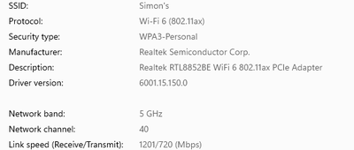

So I have a slightly different issue than what I can find on the interweb...I have a Realtek RTL8852BE WiFi 6 802.11ax PCIe Adapter that I don't believe is picking up my wifi 6 signal.

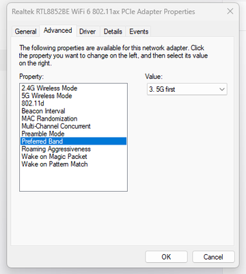

 Thats a snip of some of my wifi info for the laptop.  Best I can troubleshoot/hypothesize is I don't have an updated driver that gives me the option to choose a wifi 6 signal.  All I can find inside adapter settings is no preference, 2.4, and 5g...no 6

Can anyone let me know how to fix?  Really want to take advantage of my wifi 6 speeds if I can, thanks so much for your time and help.

You need WIFI 6e to get the 6ghz band
https://en.wikipedia.org/wiki/Wi-Fi_6#:~:text=Wi%2DFi%206%2C%20or%20IEEE,better%20performance%20in%2....
Aww...for real?  I need different hardware?  That card I have was a marketing ploy?  It states Wifi 6 but is only good for 5g?
hi @MommaHead
There is much difference in using a Wi-fi 6 than a wi-fi 5 , even if they both connect to the same 5 Ghz band.
when connected with wi-fi 5 it has a stream speed of 433 Mbps with wi-fi 6 it has 600 Mbps. Then you usually connect to 2 stream, one upstream and one downstream.  In wi-fi 5 total 866 Mbps, and wi-fi 6 1200 Mbps.
