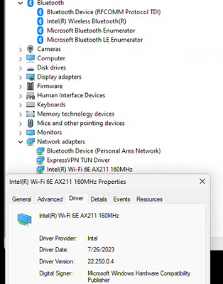

So I am trying to install these drivers, but no matter what I do, I seem to have the same versions show up as installed as what was there prior. For example, I've installed the Bluetooth driver about 10 different times now, I think, and I'm still sitting at the version shown below. Additionally, I just attempted to install the WiFi adapter driver (which says it's version 3.5.xxx) and as you can see, it's still at version 3.0.xxx.

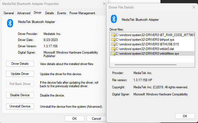

I even went to "Update Driver" and selected "Have Disk" because it kept telling me that the latest driver was already installed. When I did this, it FINALLY seemed to do something on the PC (Bluetooth dropped out, came back, same with WiFi when I did that one). The version number of the driver seems not to have changed at all, so I'm still confused. Going to try a reboot and see if that fixes the version number being displayed and/or the issue overall. Strange that I'd have to very explicitly tell the PC which driver to use in this manner - I thought that's what the *.exe was for? At any rate, will update when I know more. Thanks again for all the help, @Paul_Tikkanen and @BeemerBiker!
UPDATE: The reboot did not fix the driver displayed version number. Is it possible that it's truly installed, but not showing the right number? Also, I notice that there are several items listed when I go to "Driver Details" - is it possible that I have several different drivers installed and it keeps defaulting to the wrong one? If so, do I uninstall everything but the right version? And which one shown below is the "right version"? Thanks again in advance!

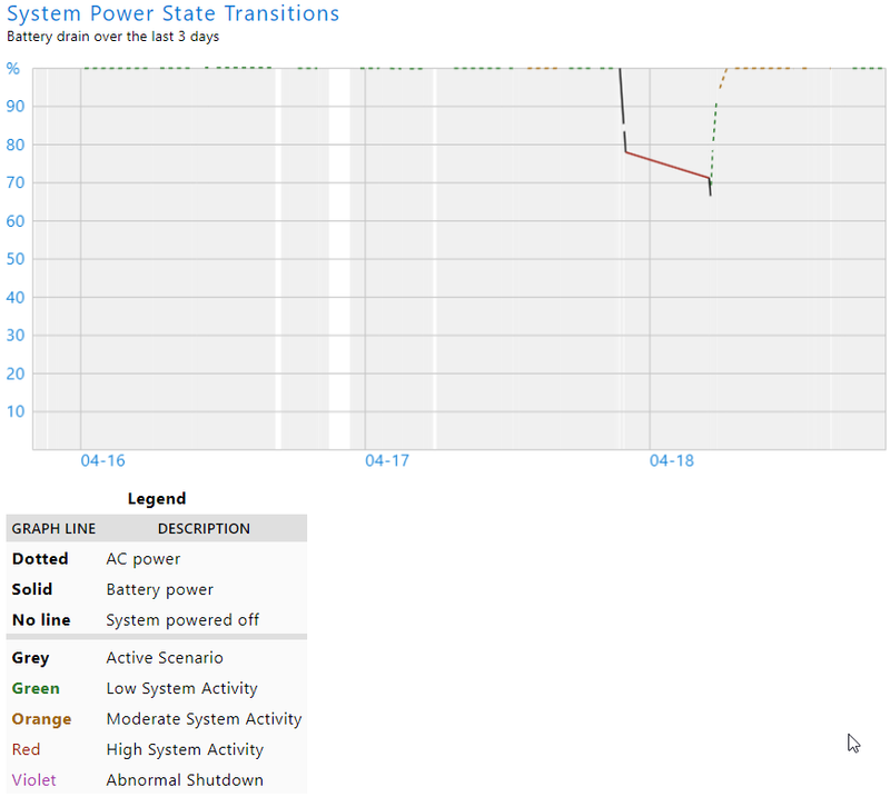

I was hopeful that the driver installation had finally worked, but alas, it does not. I had the event happen again after it had been working for almost 24 hrs!! 😒 At any rate, please see the photo of the sleep study results. I'm not sure how to read them, so perhaps you can see something that stands out? I can't figure out how to attach the xml file, but perhaps that feature isn't supported on this forum. It's quite a large amount of data, so I don't know where to begin looking. It does seem like it'd be in there somewhere!
