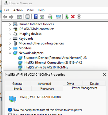

Possibly your Wi-Fi device is not waking up properly when the computer wakes up from sleep or hibernation.
The Wi-Fi device may have a Power Management feature as shown below. If you un-check the box "Allow the computer.." then the Wi-Fi device will be enabled during sleep and will not have to be woken up when the computer resumes from sleep. Laptops in modern standby will be missing the following option.
If there is a yellow bang ! then please show the device and it's ven and dev as illustrated below
If you have modern standby then the above options are not available. Please run the sleep report and sleep study  and try what it recommends.

Thank you for your advice, i tried to change the power plan for the adapter from the old control panel but it wasn't helpful, i forgot to check that box you suggested in the properties, i'll see if this fix it and report in the next days, thanks again.
