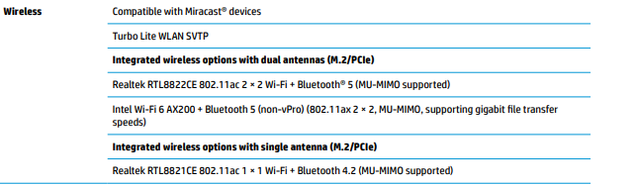

Tonight our conclusion is that we are facing a problem of Realtek Wifi card (CE) on the 250 and 255:
- The 250 and 255 have a Realtek Wifi card. At first we thought about a problem on the terminals (WIFI 4 or WIFI 5) which was quickly discarded after other tests, then a problem on Windows 10 & 11.
- After searching several hours on Windows 10 & 11 (Registry, drivers, Bios, PowerCFG, device power settings, etc.), we agree that the problem is not related to the Windows 10 or Windows 11 operating system.
- I have installed an HP EliteBook 855 G8 with a Realtek CE card with all the drivers in the HP catalog, whether in Windows 11 or Windows 10, and we unfortunately reproduce the incident We have a latency of more than 200 ms on average from a ping of a local server on the device.

• We will order an Intel Wi-Fi card (if available) to replace a realtek on a problematic workstation (with dual antenna kit). This way:
o If the problem is solved, it will indicate a problem on the card itself or on its management.
