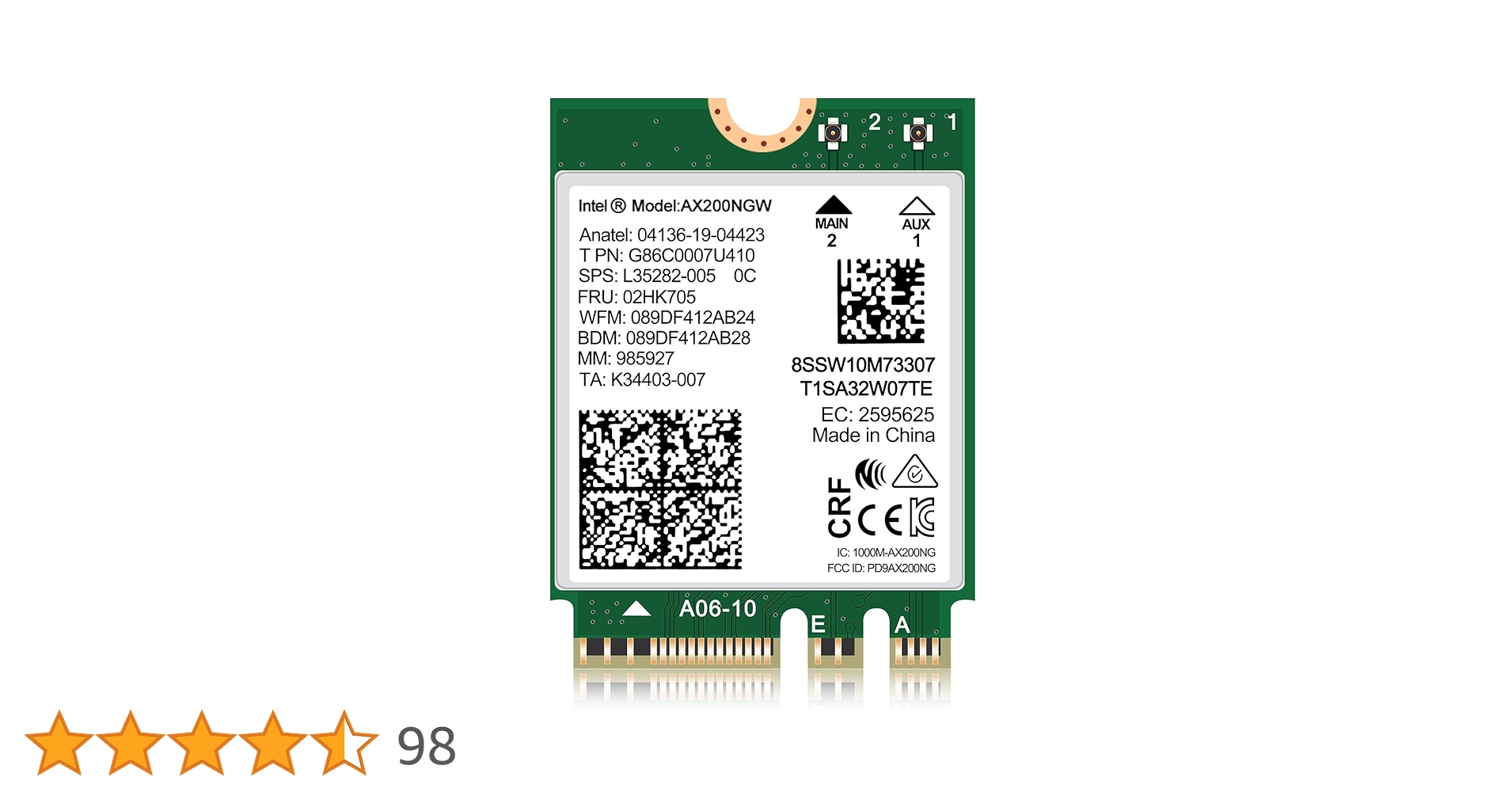

Hey hello, I installed the wifi 6 AX200 and installed a second antenna and downloaded the drivers and Jihhaaaa..... It works 👌👌...
The first WiFi adapter was wrong.
The AX 200 fits. As you can see in the pictures, I laid the 2nd antenna below the keyboard 👍

Which Intel card would work with my HP laptop......maybe the AX200???
I don't think so because I could not find that card offered in the model series.
Normally I would have recommended you try the Intel AX200 because that is the same card HP installed in my HP Envy x360 15-ee0047nr notebook which has an AMD Ryzen 5 4500U processor.
If you want to, that would be up to you.  I cannot guarantee it will work though.
This is the part number/SPS number that HP installed in my notebook:
Intel Wi-Fi 6 AX200 ax 2×2 + Bluetooth 5.0 MU-MIMO M.2 2230 non-vPro   HP part # L35282-005.
I would now try this AX200 again from the link.....
Is this automatically recognized by Windows?
You should download the drivers for this beforehand or does this happen automatically when the card is recognized?
