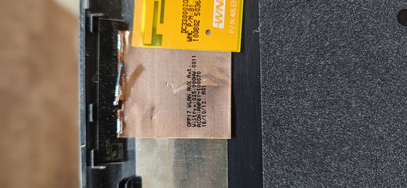

Well, I am happy to say that I have found the culprit, and apparently, someone had taken the laptop apart in the past and done some work on it, and that work included installing something that was not original as well as cutting cables that shouldn't have been cut, but it definitely explains the lack of Wi-Fi reception!
Can you take a look at these photos and tell me what I need to replace the parts? I searched online but couldn't find anything that looks like these even with the numbers on the parts entered in the search field.
Thanks again in advance!!!20250216_094350.jpg20250216_094430.jpg20250216_094433.jpg
