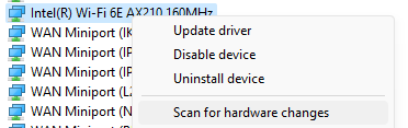

I think you are referring to the power plan for the system.
There is a setting for just the WiFi card that needs to be unchecked
If that does not work then instead of rebooting try "scan for hardware changes"
