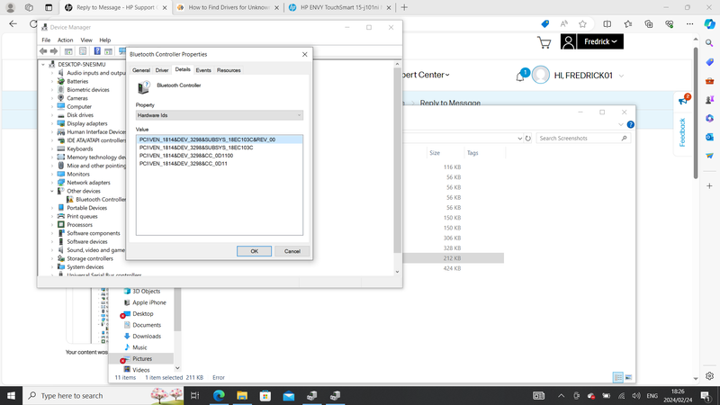

Hi, I have downloaded you driver for the Bluetooth adapter and installed it through the assistant app. It still shows that the driver is not installed in the device manager? the notebook was detected by the site and the operating system is Windows 10 64bit. is there another driver available?2024-02-24 (4).png2024-02-24 (5).png How do I fix this issue?

Please post the hardware ID for the Bluetooth Controller so I can confirm what manufacturer makes the device.
Use this guide for how to find the hardware ID for a device:
How to Find Drivers for Unknown Devices in the Device Manager (howtogeek.com)
Yes, it definitely helps.
That's a Ralink Bluetooth controller.
Here's the driver for it.  Your notebook's support page did not have the driver for this Bluetooth adapter either.
MediaTek (Ralink) Bluetooth Software Driver
11.0.761.0
https://ftp.hp.com/pub/softpaq/sp71501-72000/sp71572.exe
Unfortunately, you will probably experience the sudden disappearance of the Ralink Bluetooth device in the future because that Bluetooth adapter does not work well on the newer builds of W10.
The only solution would be to use a USB Bluetooth adapter or replace the internal Ralink Wi-Fi card with a different model card where the Wi-Fi and Bluetooth both work on W10.
