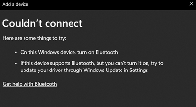

after the most recent windows 11 software update, bluetooth is unusable for me. I am using an Hp Pavillion x360 and because i'm out of warranty i can't get any direct help witrh this issue. It seems to be an issue with the realtek 4.2 adapter not updating after the most recent update, does anyone know how to fix this?

there is no issue with the wifi, it is the bluetooth that is the issue, it says the driver is working properly but everytime i try to connect a device i see this message, even though bluetooth is turned on
