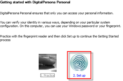

Choose ' Next '.
Click ' Set up '.
Choose ' Next '.

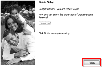

When You will do this click the ' Save ' button.
Now you should be notified that whole process is finished with success and from this time you may start using the DigitalPersona software.

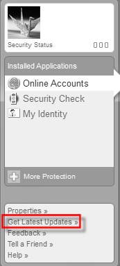

C Update DigitalPersona Personal to the latest version
Double click the DigitalPersona icon on the system tray.
Click ' Get Latest Updates '.
Choose ' Check now for sotware updates '.

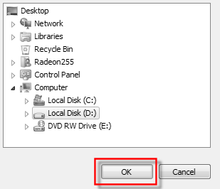

Check ' DigitalPersona Personal 4.11 for HP ' and click ' Download Only '.
Browse to the path to which you want to download this file and click ' OK '.
The download process will begin.
